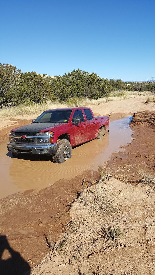

Hey guys! Now I have a few questions about the differential breathers on our trucks and more specifically the Z71. This past weekend I was out wheeling with my local club and promptly got stuck in mud and water. I know that I should change the diff fluid now but where exactly will the water and mud come in through to the diff? Also I know that some overlanders will relocate the diff breather tube to a higher location up inside the fender for water crossings. has anyone done this and is the diff breather already relocated on the Z71. Also what should I clean out after this little adventure. I was also stuck for ~4min.

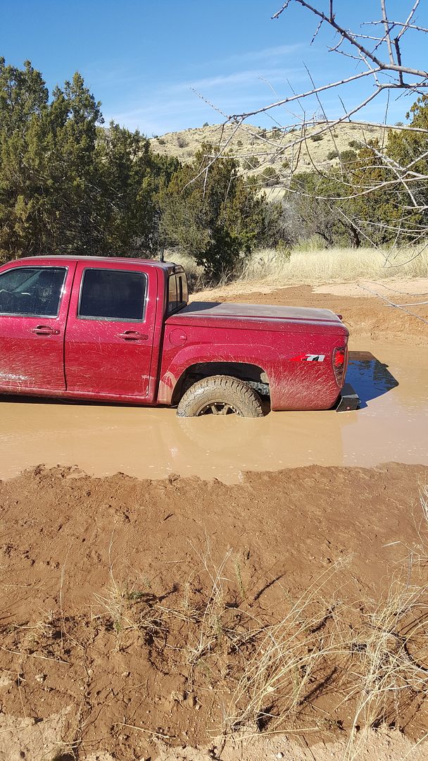

Here is how deep I was. Note that the mud only bottomed out on the axle the rest is water.

The diff breather goes from the rear end to a crossmember just under the bed, so basically if you got it in water to frame height you should definitely change the fluid.
The breather is also just some rubber tubing and can easily be relocated with a longer piece of hose and you can mount it wherever you want to. Easiest thing to do is just drill a small hole in the corner of the bed and bring it up through and fasten it in the bed just under the bedrail.

Well I was going about 25mph when I hit the pit. I thought it was a small puddle. It didn't last very long. I am pretty sure that a 4wd would have gotten stuck as well because that mud was basically soup. The dirt here in Arizona doesn't see a lot of moisture so when it rains it gets really soupy.
