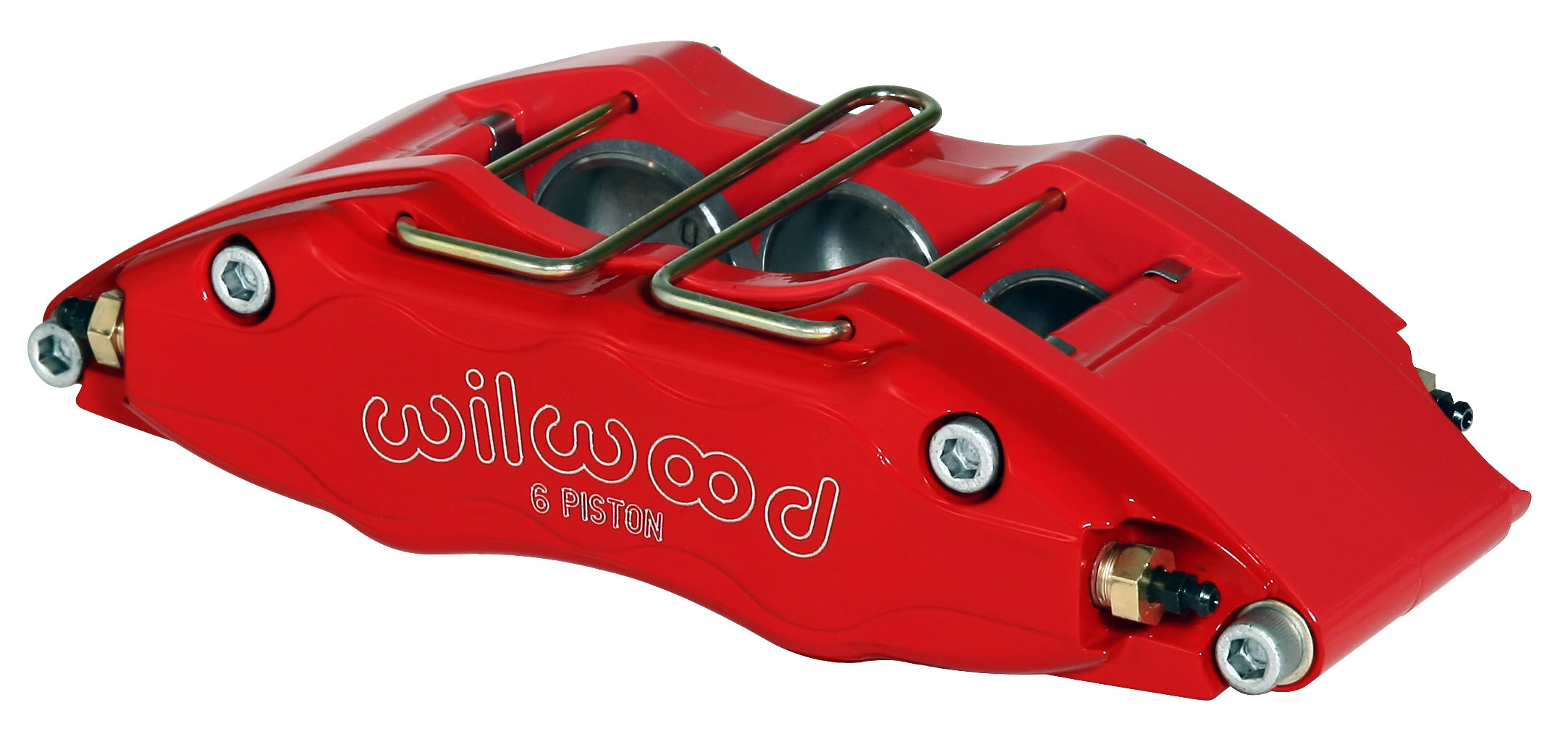

This kit I'm working on will require you to have the 09+ rotors; if you have this already your ahead of the game. This will be a Wilwood 6 piston caliper set up with SS braided lines that bolt in and connect to your OEM hard brake line.

1) Wilwood 6 Pot cailpers, they only weigh a hair over 7lbs each
2) Wilwood brake pad kit, for the street and light track duties
